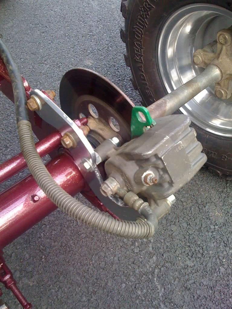

tell me what u think lol .. ok i was at the junk yard today and they had some bikes there idk make lol .. and the back breaks worked on the 1 and it was hydraulic so i got it to try and get it to work on the blaster .. it was only 20bucks so if i cant get it to work no loss haha ..

i am going to try and get it to bolt on some how, i am not trying to weld it on lol ..
What did it come off of? I like seeing peeps thinkin out of the box with mods. Street bikes have great hydro brakes to pirate.
i got it all on i just need to bolt the top on the master cylinder to the frame and run the lines so nothing get cought on them on the trails haha ..

they work great it was well worth the 20bucks haha .. i think i am going to hit up some other junkyards this weekend and see if i can find another setup for my other blaster .. tell me what ya think:)
that looks like a perfect fit. what was involved in making it fit?
umm i just had to get a longer bolt for the master cylinder thing, and i had to drill into the frame so the top could bolt in .. and i cut some steel so i could bolt up the caliper to work .. but i need to get a diff caliper cause i need 1 that the pins hold the brake pads in lol ..
Nice quick and dirty upgrade mod!!
I also put some hydros from a motorcycle on my 01 blaster. I dont remember what it was from, when I need pads, I will match them up in the book. It worked great, I did however drill and weld some nuts in the frame by the pedal and weld an ear on the stock pedal, and a bracket to mount the resevoir. Cut, drilled and tapped some 3/8" steel for my caliper bracket. I am in the process of a rebuild right now, and actually just blead them last night, they work excellent, cant wait to put them to real use. I may post pics later, of the brakes, and or whole build later in another thread.
I have used rear hydro setups off of bikes for many go karts, blaster, etc. I used a front hydro brake on one kart, but I like the fairly new rear ones, because of the nice small and easy to mount master cylinder. They have a little clevis that works great putting it on your own pedal or whatever.

niceee can u get some pics .. u trying to sell any of the calipers i may pick another 1 for a spare ..
thats nicee I:I.. where did u buy that mount for the caliper??..
I custom CNC it out of 3/8" steel, then powder coated it argent silver.
It works excellent! I just need new pads. I did some major custom metal work on the brake lever and the peg if you want a picture I will take one and post it for you...
