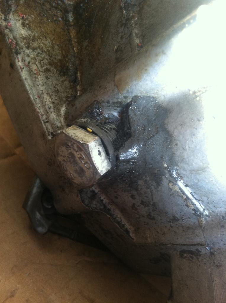

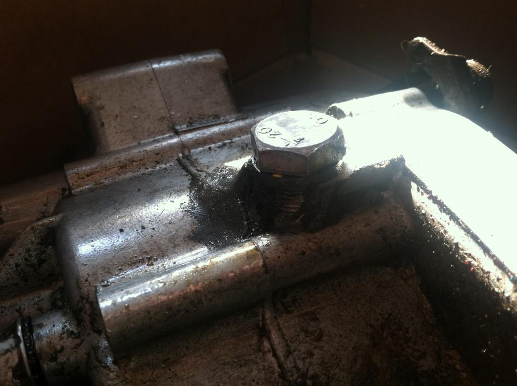

Longview Member Mar 16, 2012 1,073 20 43 28 Attleboro, Massachusetts www.facebook.com Jun 18, 2014 #1 Got an engine for 60 bucks, i doubt that is fixable so i'm going to need to find a new case on ebay.
Herpderplol BRRAAAAAAAAAPP Aug 22, 2012 6,290 497 136 27 Dickinson, ND Jun 18, 2014 #2 have the hole welded shut and make a new drain plug on the weld or close by

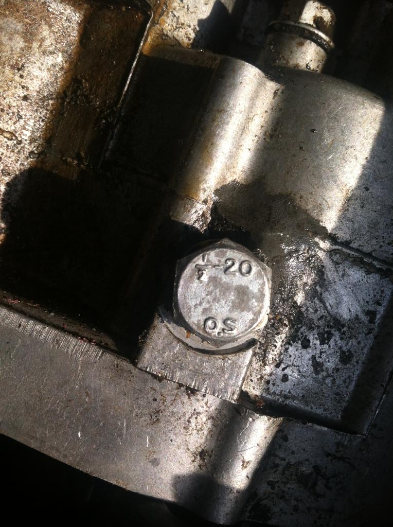

speedyslyder 2 STROKES RULE Technician Feb 14, 2014 4,274 828 178 45 massachusetts Jun 18, 2014 #3 its not the oem stock bolt either that might have not helped
Herpderplol BRRAAAAAAAAAPP Aug 22, 2012 6,290 497 136 27 Dickinson, ND Jun 18, 2014 #4 wrong threads priobably did it then
Bluesman Member Aug 13, 2012 618 147 94 Jun 18, 2014 #5 Self tapping oversize automotive oil pan drain plug and they just jammed it in there. Jeez! Somebody needs their toolbox taken away from them. They're not smart enough to own tools.
Longview Member Mar 16, 2012 1,073 20 43 28 Attleboro, Massachusetts www.facebook.com Jun 18, 2014 #6 Guy was like "hmm never seen that before" what did you never change your oil?
Awk08 Administrator Staff member Technician Jan 30, 2009 24,427 2,295 175 Usa Jun 18, 2014 #7 could have been a rock jam up in there from not running a full frame skid plate Reactions: motoman159
