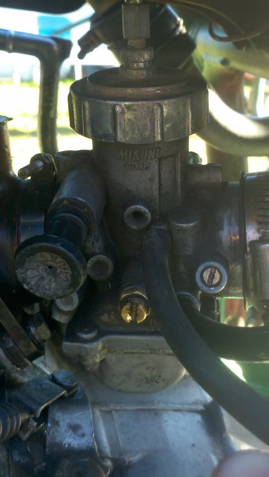

how do i adjust idle ? what one ?
purpleblaster
Feb 20, 2012
64
1
i have a 91 blaster no tors here is a pic what one do i adjust i tried the bigger one it doesent seem to do much
i have a 91 blaster no tors here is a pic what one do i adjust i tried the bigger one it doesent seem to do much ]
Looks like the big one with the lock nut has done a lot of work and could be plain wore out.
Remove it, take off the locknut, put it back in, and try to raise the idle again.
The carb slide may be worn too, where the idle screw contacts it.
If you get the idle to raise, get it to a high idle and turn the air screw either way, in little increments, to get the highest speed.
Wait a while between adjustments to allow motor to compensate to adjustments,.
Turn the big one back out to set the correct idle. Warning it is a must to have the lock nut on the idle setting screw otherwise it will fall out, causing you greif.
If the carb slide is worn, you can use the adjustment on the cable to adjust the slide height.
The only drawbacks are that the idle may rise, and speed increase when riding, when you turn the handlebars.

ok well the bad happend as posted by blaaaster ... lol i was trying to adjust it dident work so i just tightend the big one all the way then loosened it a little then the big one fell out so its lost .... were do i go from here ? .. do i need to buy a new screw or am i better off buying a whole new carb

take the carb to a dealership, and have them find an idle screw that fits and is slightly longer, i got a thumb style idle screw with a spring that holds it in place instead of the locking nut style, worked great

thanks so much i called the quad repair shop today and he seemed to have no idea what screw i was talking about since the tors was removed he was very confusing to me i disslike this guy but hes the only shop close by he said he would have to look at it . am i crazy or does that screw even belong in that spot because on the link i posted for oem parts it did not list that screw. also as i said prior when i would adjust this " so called idle screw" it dident do much of anything at least nothing i noticed at all chaning the idle .... sorry for being very lost but idk much about carbs or quads in general .

you are not whacko,
that idle screw in your pic, is part of the aftermarket tors delete kit, it is not OEM/stock, so it will not show up in any diagram or manual.
i suggested others, (spring style) as i am not a fan of the vito's locking/jam nut style. i had one before, it came loose and fell out on the first ride, and i'm a notorious "over tightner"
that is exactly where it needs to go, your slide has a divot just for that to push up on, in that exact spot
it will cause a major airleak and go boom if it is run without the idle screw in that open hole
