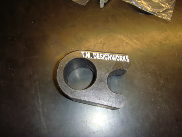

So I just got my TM Design chain roller kit. I'm very confused as to how they go on. Please help with any suggestions thanks guys.

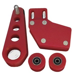

Bronco's walkthrough sums it up well! Did you buy the kit with all the sliders and rollers included in it? I've been considering buying that kit as well.

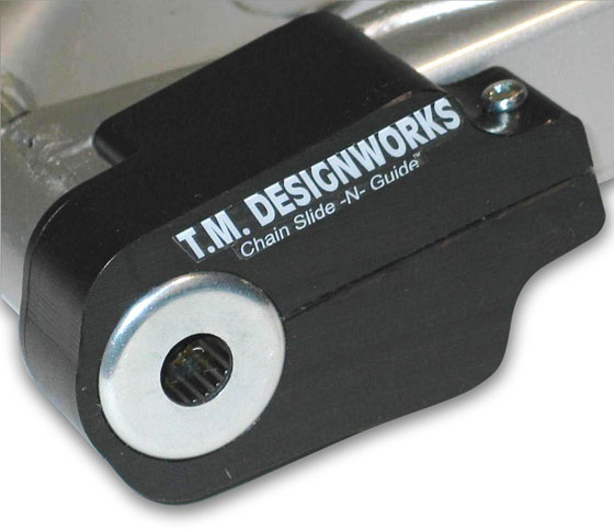

Take another look. There is an upper roller mounted to the frame above the chain. A lower roller mounted to the frame below the chain, and if it's still there, a white plastic roller that rolls on the front of the swingarm. You want to get that white swingarm roller off of there, and the thin steel sleeve if it has one, and replace with the aftermarket chain slide that does not roll. There are a few different types. It's best to remove the swingarm to install it, but some slides can be installed without removing the swingarm. You just have to dig the stock stuff off of there.
