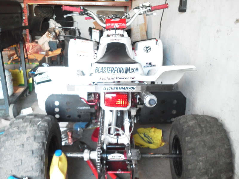

i run yfz's on my black bike, takes a small metal bracket for the top mount on each side
