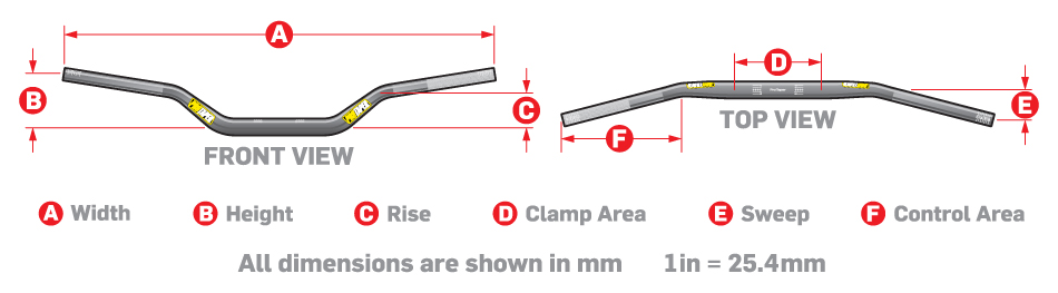

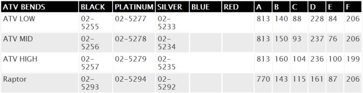

only an atv high bend will have the cross bar higher, mid bend a little higher than what you see, which may just be a stock photo, study the charts to see the different widths, rise, control length and sweep of each bar. (it's down in the details of some on ebay, or go to pro-taper/renthal/moose ect. website for the details of each bar)
i can tell you, you need 8+ inches of control length, and most bike bars lack that, only bars designed for atv's have enuf for the added thumb throttle width
those ones for bikes are really low, and like i said, the thumb throttle and master cylinder may not fit, they are made for a twist throttle and a master, then bend down towards the mounts.
choose wisely grasshopper I:I
ok, a little lesson on bars for you, trust me, you want atv bars, not bike bars............
the measurements are in MM's
Lots of numbers and lines... I will never understand them :p:p

you actually have to read the height in the chart.
atv high bends will work
