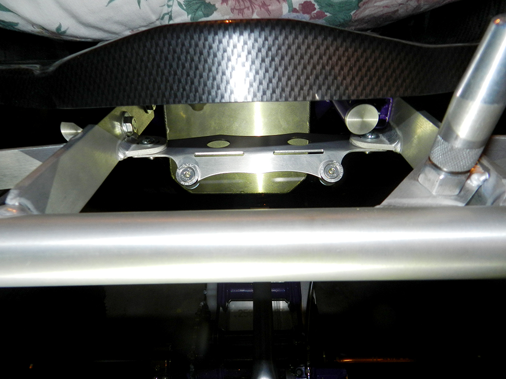

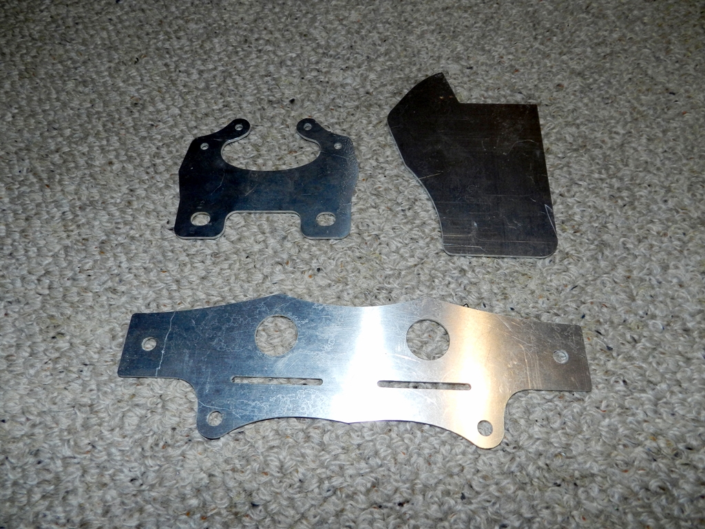

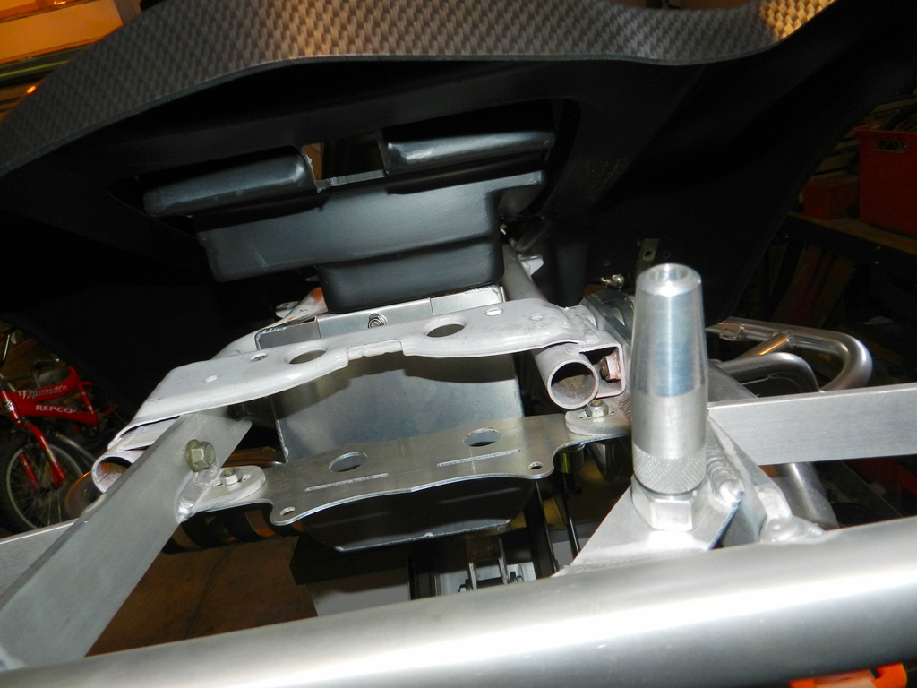

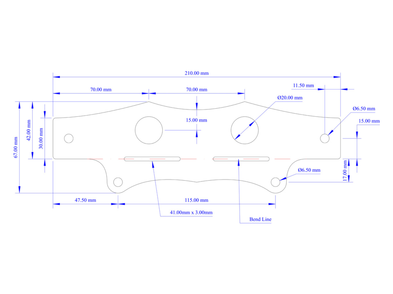

Hi all. Just finished drawing up my new rear number plate mounting bracket that mounts to the grab bar. Will be CNC cut out of aluminum.
It will mount to the two tabs on the grab bar
Download PDF: CLICK HERE
Download DXF: CLICK HERE
Might help if some one wants to make there own. 7x10" Boards will fit or make a custom size one like I will be.
Upload photos of finished product Soon. Also will let you know the angle to bend it to.
