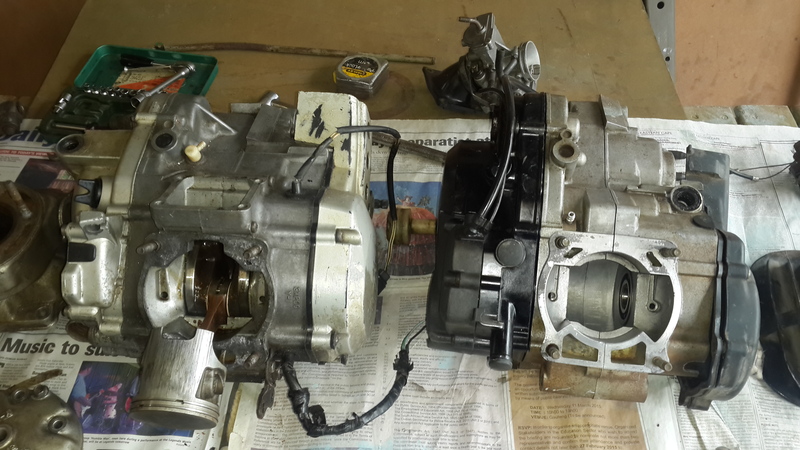

Well, here it is, needs some TLC, but has loads of potential. Having another look at things, turns out, the WR200 does not share casings with the YFS200 and the DT200. It hasa unique setup. However, having checked it out, I noticed only two possible snags.
1: The lower read engine mount is higher than the YFS, meaning it needs a bracket to extend the frame mount.
2: The exhaust port lies at a sharper angle to the horizontal than the YFS, this should be overcome but adjusting the exhaust hangers a touch.
Other differences, which are not really problems include:
1: The clutch pivot arm is on the opposite side, no big deal.
2: Intake feeds into the crankcase - Awesome!
3: The intake and reeds are 10mm wider than the YFS, much larger intake volume capacity
4: The Jug reads "199cc"
5: The piston is apparently 66.8mm standard - not 66mm.?
I can fit the cylinder of the WR onto blaster casings, and vice versa.
The carb is a Mikuni TM. It looks like a 30mm, unless my vernier caliper is playing up... Trouble is, the slide and spring assembly is missing. Anyone able to help source one of these? Did Mikuni make a TM30mm?

Hi guys i havnt been on here for a long time.. im in australia..wr200 and dt200R are very similar engine wise both engine cases are the same, dt200r steel liner wr200 plated, wr has bigger transfer ports and intake and no oil pump..the biggest differencec was in the bike its self..chasis suspension brakes all basicaly yz125 for the wr200. The dt200R is very common here cheap and plentifull. The wr200 is also common but no where as much as the dt as not all wr200 had compliance to ride on the road.
The dt200L, which shares its bottom end with the blaster is not that common as they only made them from 84 to 86..the the dt200R,crank case inducted motor, from 88 to the late 90s , dt230, longer stroke dt200 with plated bore, we got also from late 90s to early 2000s but very few of those also.
The crank from blaster will not work in the dt200R/wr200 due to its shorter crank primary drive side which is needed to carry an extra gear to pick up the water pump on the dt/wr. I have heard of someone making an extension but to my knowlege never was trialed. But Where there is a will there is a way..
