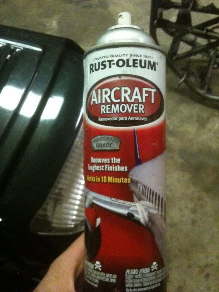

The way I did mine was to use aircraft paint stripper. Clean the frame with a hood degreaser. Spry and wipe it down with pre(a pre paint cleaner). Spray the self etching primer then paint.
if you want to go the sanding route i suggest getting a cheap sandblaster from ebay, there are some for 30 plus shipping that attatch to your air compressor. if u dont mind me asking dakota, how did u get your hands on aircraft grade stripper, where could i get it?
