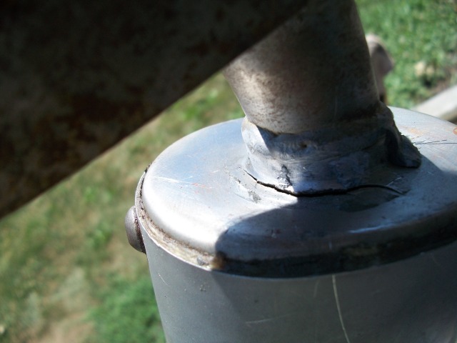

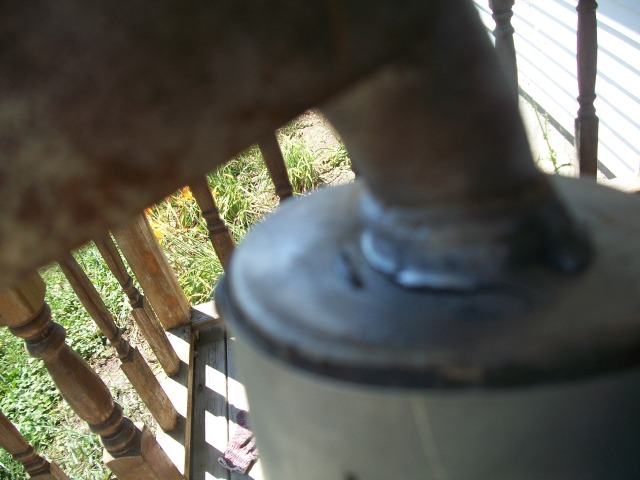

Now the power core, has a issue. Looks like a cracked/ damage at the pipe to silencer connection. And someone attempted a JB weld repair at what time. which is no longer a valid repair.
Now can I get this welded or try a JB weld again ?

you should be able to grind out the old jb weld repair and re weld the broken pipe. maybe get a piece of exhaust pipe to replace a bad section if needed. good luck
and also the website for fmf sells just the flange needed for 30 bucks
The 500 degF engine paint might not last but at least it's easier to apply than the other stuff.
The silencer cracked is going to leak splooge but that's into the silencer body itself, it shouldn't affect performance....
Other than that, looks good.
My relative knows a good aluminuim welder. but that stuff is pretty thin, I might have him try to weld it or try JB weld, or just use the DG one.
I would have to take the packing out of it also, before he welds it, if he can.

Take it as seen, if JB has fallen off before, it most certainly will fall off again.
There is no way that JB will butt weld, get it welded properly, before it breaks off completly.
