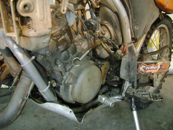

This is the carb on my KTM powered Blaster:
(Hoses removed for clearity, mud left on for realism...)
A slight twist of the carb and the cap and slide come out easily.

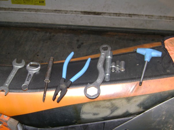

KTM "Fix everything" tool kit:
Once the slide is out I have a 6mm special screw to remove on the Keihin, some carbs have a Philips screw and some are just a hooked cable and spring. Once out, you have access to the needle. I gently press the "E-clip" against something to unclip it off the needle. WHATEVER YOU DO, DON'T DROP ANY PARTS! I reclip it where I need it and put it all back together. About 5 minutes work.
Do not over tighten stuff, or you will strip the cap or Philips screws. I like to put graphite or teflon spray on the throttle cap screws to preserve them and keep them removable.
Hope this helps!
