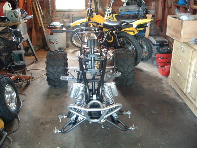

Buy a siphon sand blaster ($20) and a few bags of sand ($5 for 50lbs) and have at it. The most important thing is to make sure you get off all the dirt, oil, and grease. I always use a pre-painting prep product. You can get it at most any autoparts store. Wipe it all down real good after sanding/blasting. Use a sponge it won't leave behind lint. As stated earlier it really is all in the prep work. I used a siphon blaster and a spray can for my own frame.
