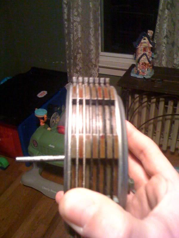

I put it in the right order, but now there is too much play in the clutch, almost like there is a plate missing. help!
Is there suppose to be space in the clutch basket?
because i can move the friction plates back and forward inside the clutch basket
there shouldnt be any play in the plates....did u put the pressure plate on and torque the springs down and still have the play

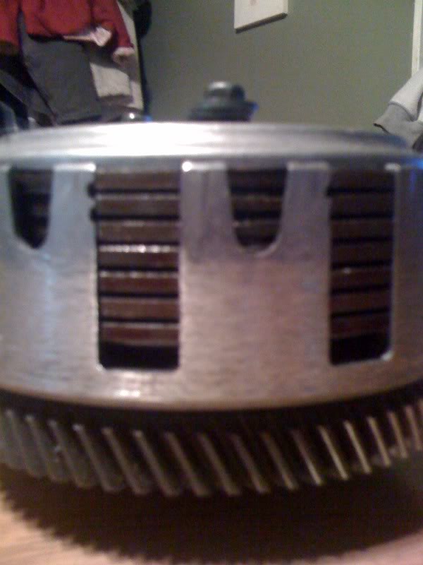

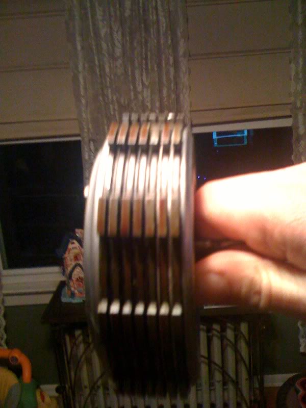

heres how the assembled basket and clutch pack should look.
Thanks a lot! I figured out what was wrong...lol. It didn't go on right cause i didn't realize there was grooves on the inside of the face plate that fit over the clutch hub. The only bad part is that i snapped a spring bolt...:-(
