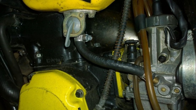

Ok so on the clutch cable where it goes into the clutch cover there is a long spring on the cable.. Is that spring supposed to compress when I pull the lever in?
That spring on the cable, is it supposed to compress when the lever is pulled?
