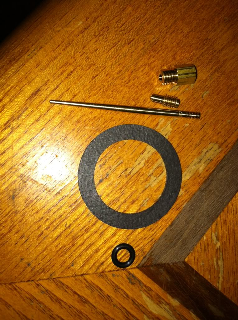

Okay so from top to bottom these are the parts I didn't use... The top 2 are the jets obviously the needle is for the trotter slide right?
But wth is the paper maybe gasket bigger circle... An the small
Rubber gasket.

upper 3 are jets, the little o-ring looks to be the choke plunger o-ring and i have no clue what the paper gaskeet is for.
Depending on size the O ring could go under the seat of the needle assembly.
Me thinks the round gasket could go under the carby cap.

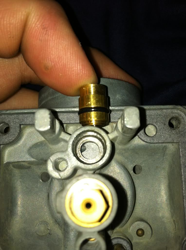

Hey blaaster I don't know if u on to something check this picture out!
Is the only I ring in there the one on the seat there or is there suppose to be one under it?
