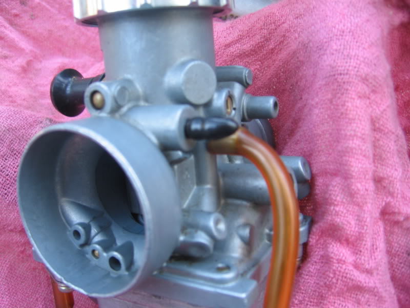

Hey guys, I am need of some help with my blaster, just recently got it up and running except for one major issue. My oil injector line does not fit into the carb. like it is supposed to. Can someone post a picture of their blaster on the right side of the carb. fully assembled. I just need to see what one is supposed!! to look like, so i may get an idea of what I need to do to secure the line. You guys are my final hope I:I

heres the oil injection nipple where the line hooks to........
So what your telling me is, that line in my picture hooks up to that small hole? DOH
I thought it belonged in the bigger hole there. At least thats what my buddies were saying. X(
Yes, it goes in the small upper hole, as in the first pic, what concerns me is the brass nipple pulled from the carb body, is it gonna come out again while riding ???
