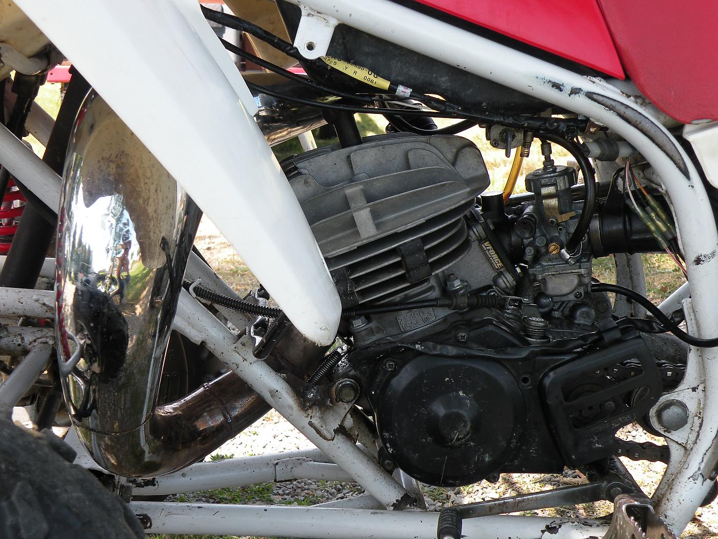

Hey, I got a 1989 Yamaha Blaster bored to 240- Vforce reeds- mikuni carb- K&N airbox- oil blockoff- and Kenda Klaw MTX tires..... Problem is the other day i was riding it and it stalled while idle after riding. I was in the driveway and kicked it about 10 times before it started again, and the only reason its started is because i cracked the throttle, when i floored it it felt like it was just idling and then it revved a bit and a huge cloud of black smoke poured out the exauhst real fast and it ran fine...... Next day I was riding and she stopped dead in the yard, would not run at all. Tried popstarting it... nothing, clean plug, nothing, air out the cylinder to ensure no flooding, nothing, finally it just..... started on a kick and and where the exauhst and the pipe meet (with the rubber gasket right next to your right leg) it spat BLACK oil onto the fender and out the pipe for just a seccond and ran fine...... :o Today, it runns fine exept white smoke out the pipe that smells like gasoilene and only gas, when idling cold if you just tap the throttle it stalls but if you crack it it revs. (the exauhst smells nothing like the gross tranny oil)

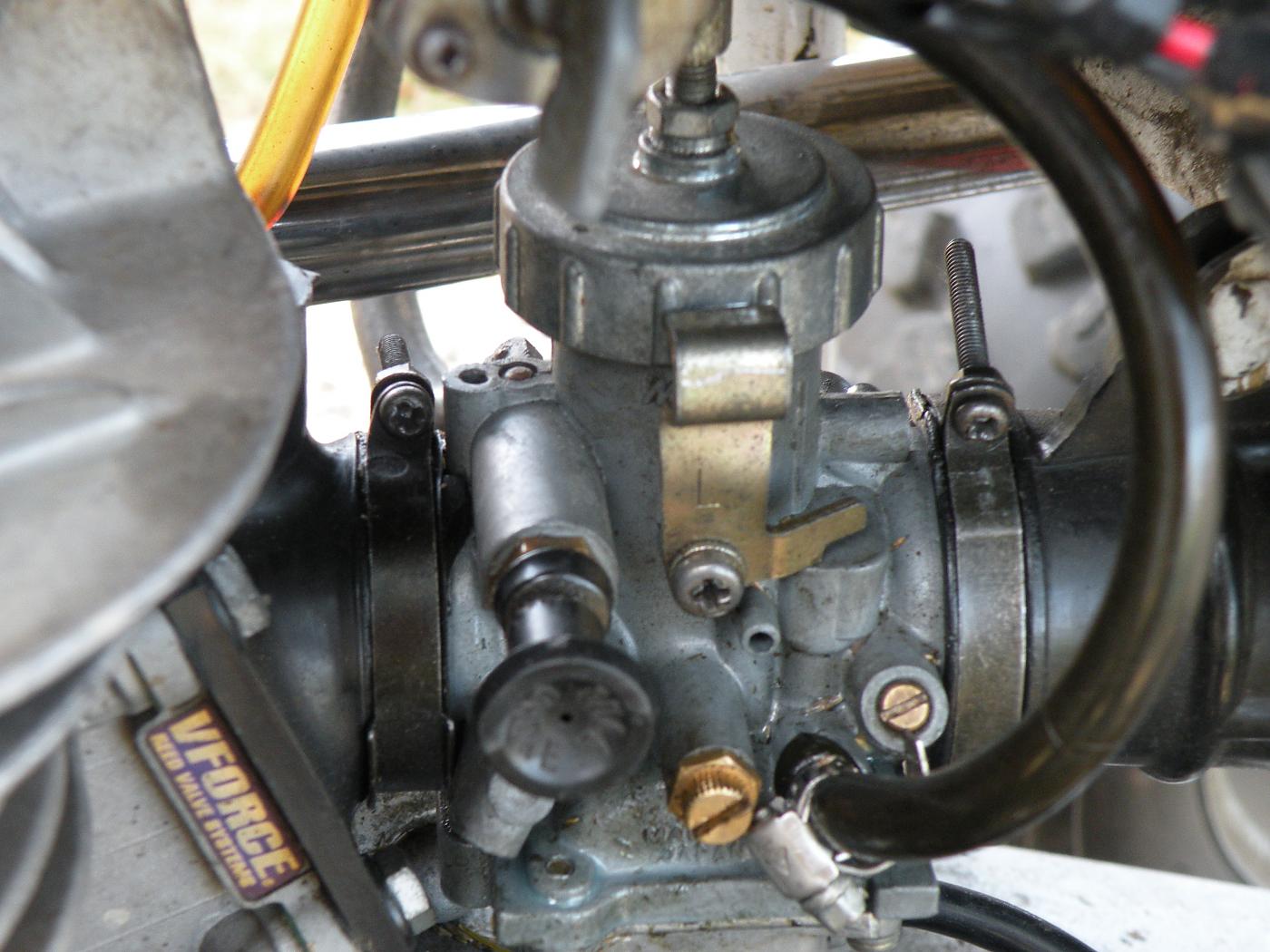

sidenote- The carb has a tube comeing out of the bottom of the bowl and looks like an overflow, and if the fuel line is open and the tube is pointing down, it dripps gas almost constantly. :-/
Ya, Im not exactly up for taking anything more apart on that bike. It runs after its been sitting for a bit, maybe I can get some guy to buy it :P But I realy thing its the crank case gaskets that could be busted letting oil into the cylinder :( this realy sucks
Mostly because black oil dripps from the silencer and that gasket around the expansion exaust chamber was spitting raw oil after it stalled. The white exaust smoke smells like gasoline, sure, but there is still wet oil running off the tip of the pipe. I guess i could clean the carb, no big deal, but I cant reason why it wont start, then when it does it make 1 big puff of black smoke, then just stays between pure white like steam and grey from the oil mix. (Using Valvoline 2stroke, Just bought Castrol super 2stroke oil).

Carb is not dirty as far as I can see, but I also dont know how to tune this one..... :-/

Ok, I have narrowed it down to tuning now (I hope), and I still need to buy some carb cleaner just to be sure, maybe something that i can pour into the fuel to clean it all out. Still blows white smoke almost as white as steam, and when I lightly tap the throttle (like barely touch it) it wants to stall but sounds like its sucking a lot of air in. I still dont know how to tune this carb, there are like no screws on it at all..... :-/ But it runs now, rides and im stummped on the white smoke that smells like regular gasoline. (I smelled the tranny fluid, gross XP )
While something like Seafoam may be good for getting residue out, it will not remove anything solid. All it takes is a screwdriver to pull carb and take float bowl off. Look for dirt or debrie in bowl. If you can take main and pilot jet out to be sure they are clear/clean. Even with that I still don't know if I'd ride it with the smoke issue. What kind of oil are you running? If trans smells bad it's probably time for a change. Is it low now?

Does this carb look right to you? :-/
