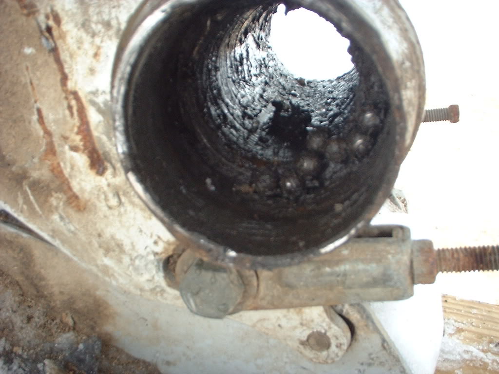

Alright start off by getting your work area set up and everything in reach. Then for use further on in the job, ice your bearing and seals. Then take the codder pin out of the castle nut on the left tire. Once out tke your 7/8 socket and take the nut off. It may be hard i had to get a 2 foot long breaker bar. Ok now prop the machine up with somthing under the skid plate, doesnt need to be too high just enough to get the tires off the ground. Pull that tire and spindel off the axle. Now pull the axle out from the right side. At this point you should be here:
[/IMG]

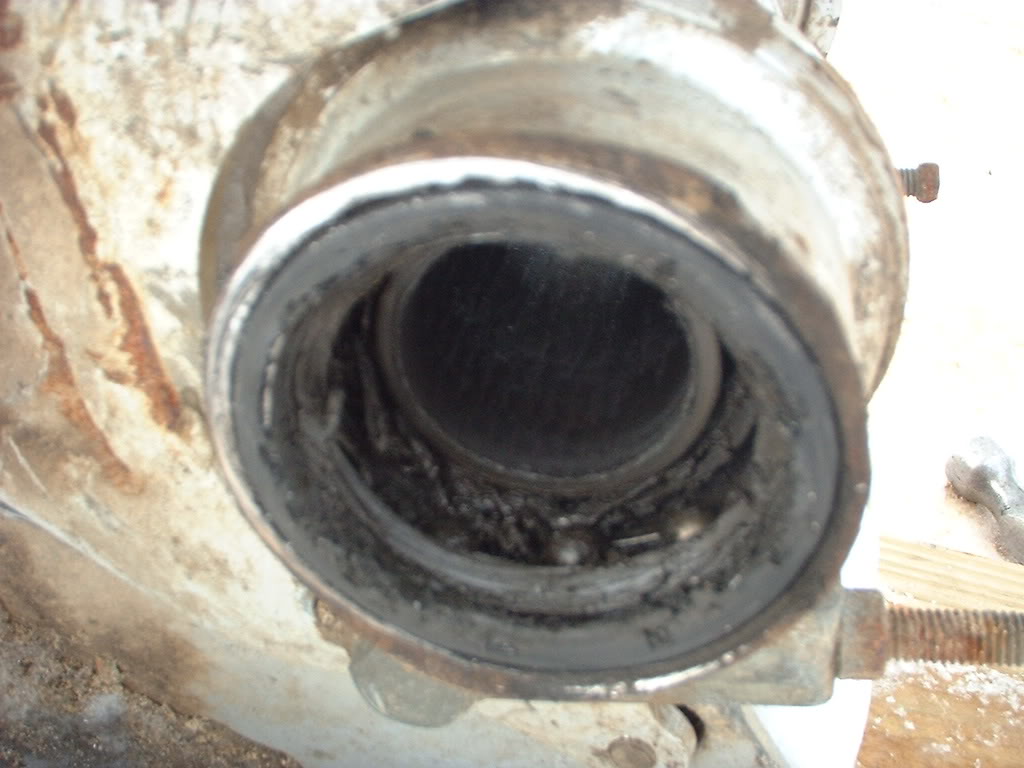

Now pull out the seals (if there still there) with the claw end of your hammer. If you dont have a hammer a flathead screwdriver will work. Just go in the criss cross patern.
[/IMG]

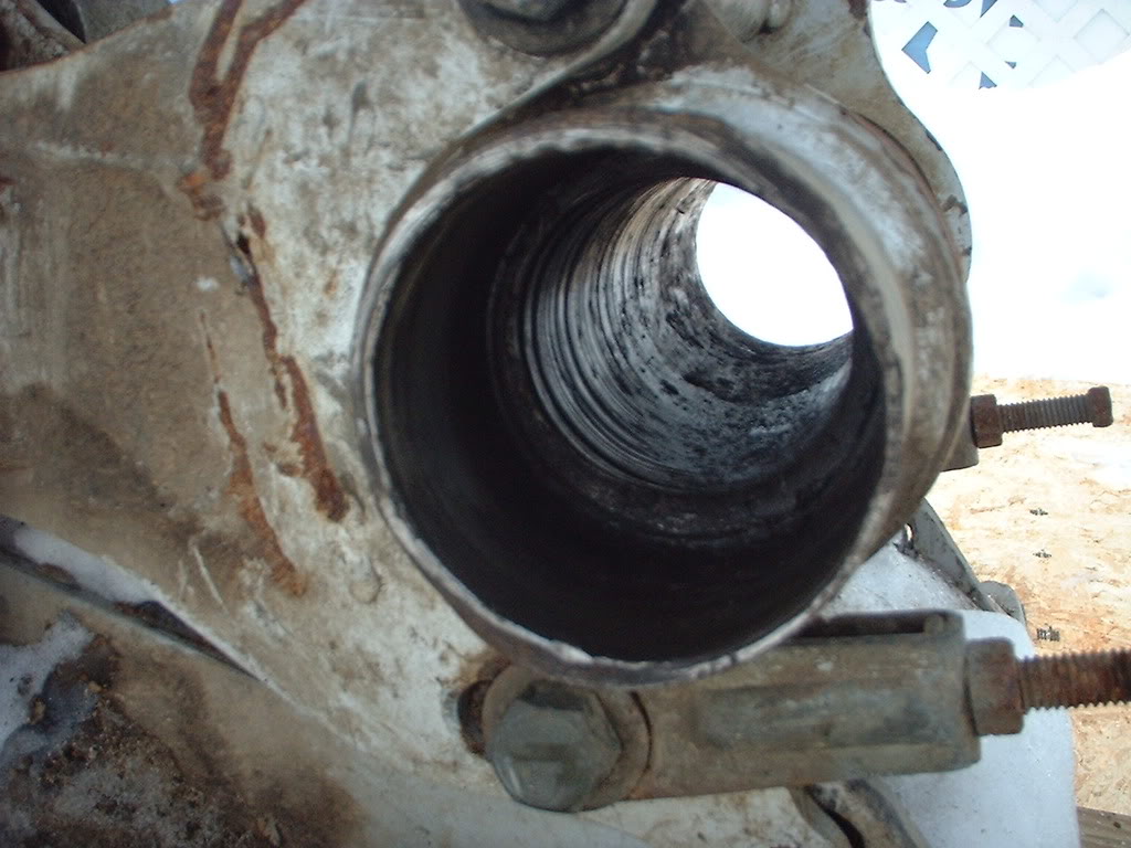

Once they are out you can now start work on the bearings. Go for the best one first, in most cases this is the right hand side. If possible use the same techinque as you did with the seals. Use your claw end and criss cross around the bearing be sure to set on the bearing, not the carrier.
[/IMG]

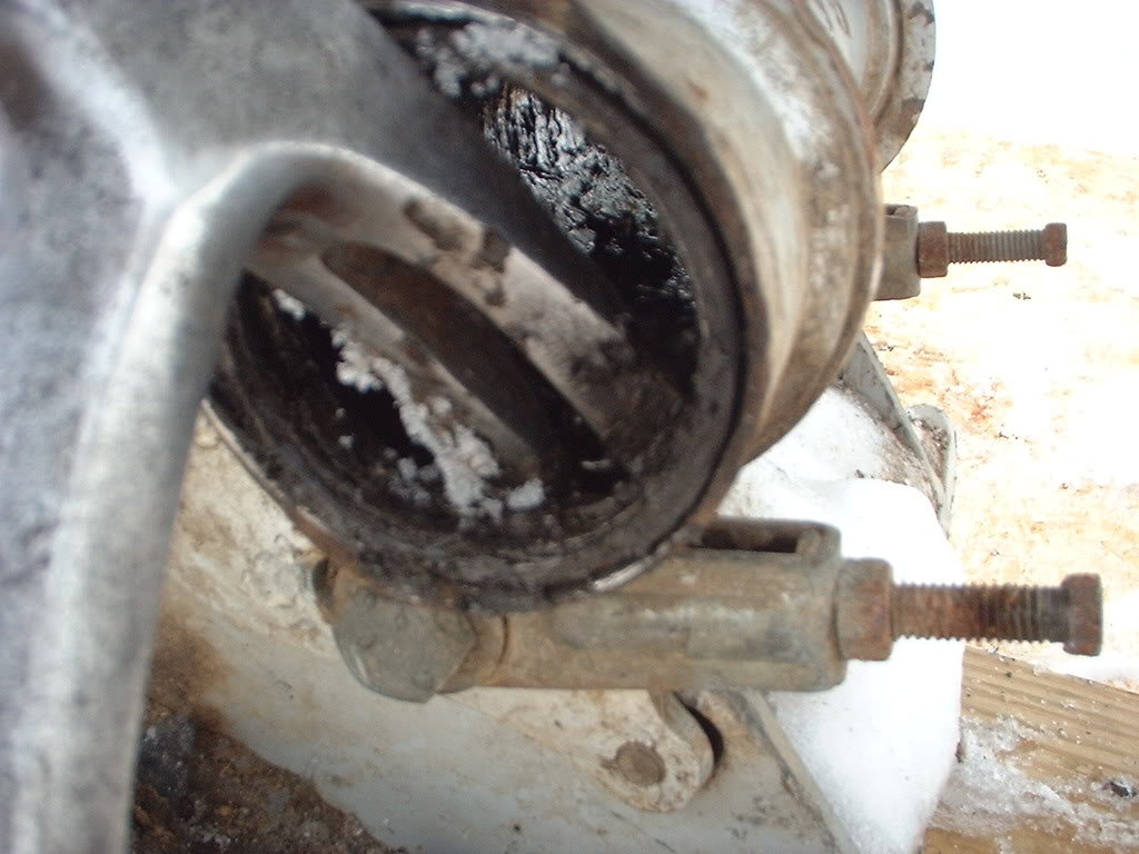

If you cannot use this method or the bearing will not move use your punch or your screwdriver (depending on which you have) to tap them out. Set your screwdriver on the bearing from the left side thru th carrier. Use a criss cross patern. Once the first bearing is out remove the inner sleeve from the carrier. Now you have a clear shot at the more mangeld bearing.
Starting with the claw try to pull any thing out that you can from the remaining bearing.
If you get luckey then the whole thing will come out in your hand. If not the inner race, and the ball bearings will come out leaving in the outter race.
If this happens and the claw will not work go the oppisite side and use the punch or screwdriver and tap it out. In some extreme cases i have had to use a wood chisel to break up the outter race. Once thats out you should be left with this:
Here is were your rags come in, clean everything out youe possibly can. Old grease, grime, dirt, balls, shavings, water whatever, get it out. Try to scrape any carbon build up but try not to scar the carrier while doing so. Do not use any kind of grease dissolving spray or wash unless you intend of COMPLETLY getting it ALL out or it will disslove the new grease and cause your bearing to fail prematurely.
