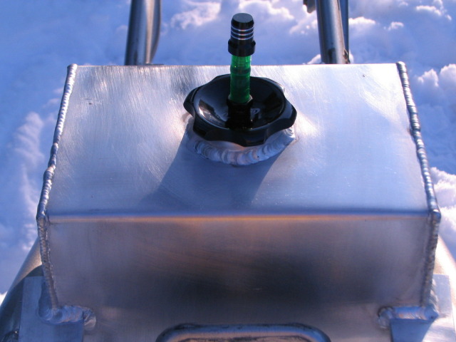

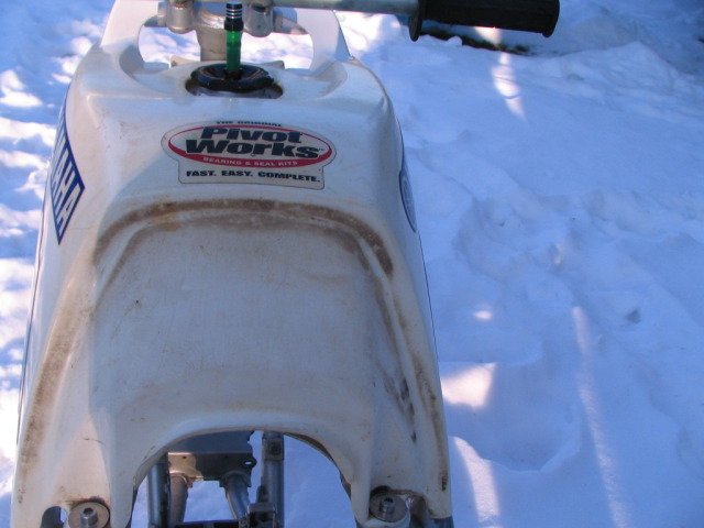

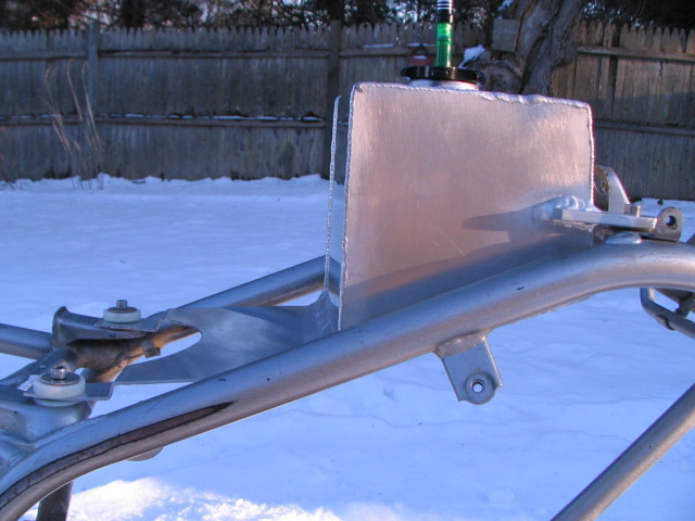

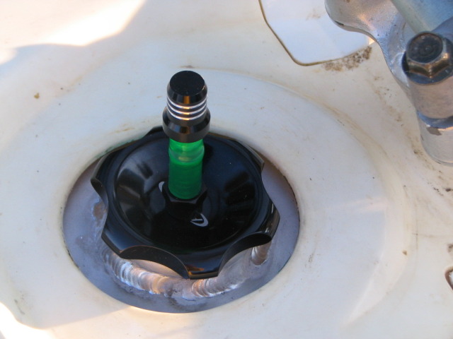

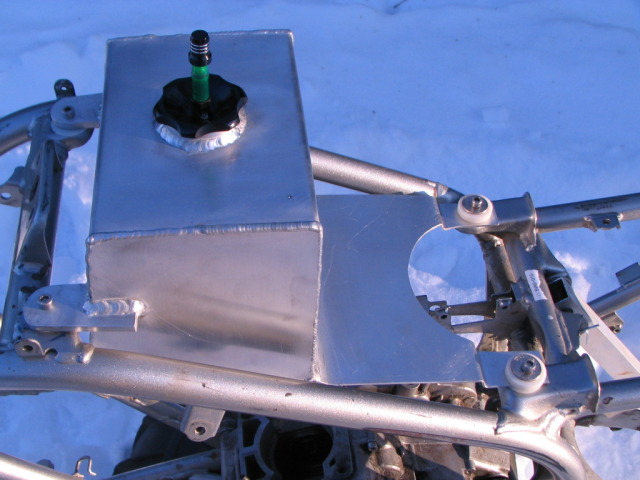

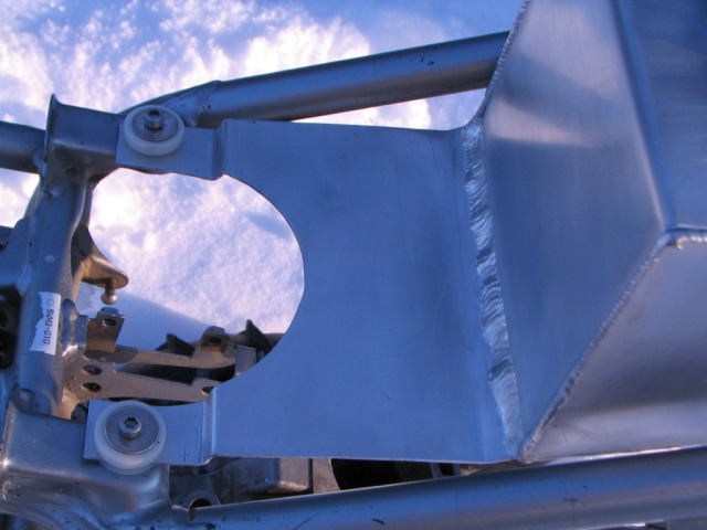

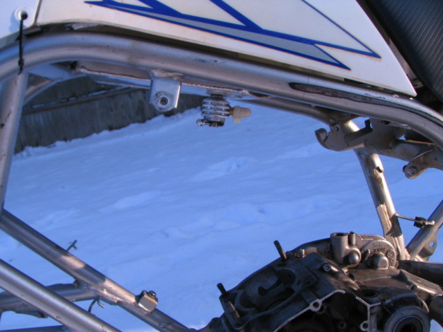

Been working on this for a short while and just finally finished this up.I was looking to be able to see how much fuel is actually in the tank,gaining more wrench room,and a tray to be able to mount all my electronics.I made some delrin spacers to take up the difference of the stock tank grommets.I also used nylon washers to keep the two disimilar metals from touching.I also wanted this tank to fit under the stock tank cover.Here is some tank pics.
