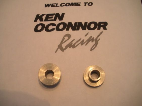

These bushings allow you to take the 400EX rear shock and mount it to your Blaster. Simply remove the old shock, drill the bottom mounting hole of the 400EX shock to 10 mm, install the bushings ( takes about 3 seconds ) and bolt it all together. Bushings are made of 1018 carbon steel and can even be welded into the frame if you want. The price for members of the Blaster Forum is $18 shipped to the lower 48. Call me if you need international shipping. There's been quite a bit of referrals and interest in this product so I posted it here to save some members time. I have a video on you tube that shows how the shock works, why it's better than stock and how to install it. Just search “400EX shock on a Blaster” to see the video. If your interested in purchasing a set, shoot $18 to my pay pal @ jessie7350@yahoo.com or you can email me @ kenoconnor07@aol.com. Lastly, please check out my web site..Ken OConnor Racing, High Performance Motocross Engines, Performance Modifications, Motorcycle valve jobs, Motorcycle Crankshaft Rebuilds, Motocross Cylinder Porting, Motocross Cylinder Head Porting.

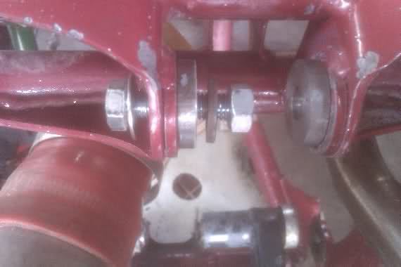

as kens little note in each set of these bushings states, some of our mounts are a tight fit for these bushings, as mine are.
i used kens bushings on my black bike, but on the outside of the mounts for the trx250r shock, they are not as tight a fit as on my bike
i gave up my last set with the works rear shock i sold, and started installing my elka today
so heres what i came up with to help install these on any mounts that seem a little tight, and to keep from beating them in, possibly damaging them, which is almost impossible because of the close quaters between mounts, ya just can't get a straight shot at them
just a simple bolt/nut and washer on each side, tighten the bolt/nut and press the bushings right in !!!!...................
Tuuuuup. Just installed mine Monday. Very nice. Mine was a little snug but went in with a little taping with a screwdriver shaft. Used my 15/32 drill bit for the bottom. The drill bit worked great. Nice tight fit.
