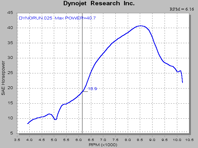

If I was willing to spend that much money, I don't think the CT Sonic BBK is outrageously priced. $1500 but it does come with the supporting hardware (reed cage, intake, carb and CT Racing right bend exhaust system) Their dyno for this engine shows 40+ HP.
That may be the most I've seen documented but it was their dyno and their engine and we all know how that can do.
