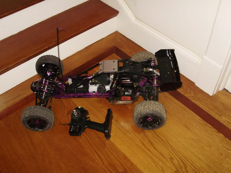

This is my new R/C. It's a 1/5 KM Baja- a HPI Baja 5b clone.
I read rave reviews about it and my honest opinion is it has some issues.
The radio antenna pulled in half after the FIRST pull. I had to rebuild the pull start before my first run because it wouldn't engage. The stock 23cc gas 2hp motor runs well but everybody know 2hp ain't cuttin it around here. If you've thought about venturing into the 5th scale world save your money for a real HPI Baja.
With that said who can afford the HPI??? This one is half price. I also happen to have about 15 years experience with these motors an just happen to have spare bore-kits, pistons, jugs, heads, ect laying around haha. Were gonna turn this into a wheeling, tire burning, nitro swilling monster :)
Here's a pic

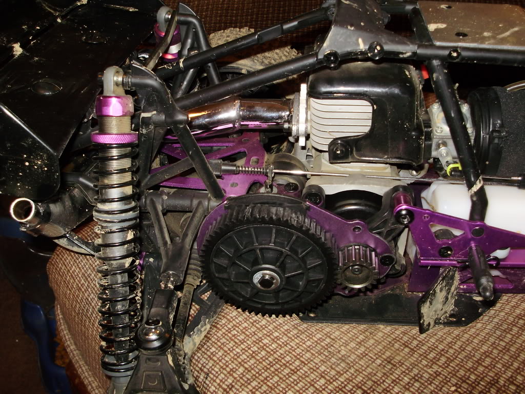

Second is a take off with jes the alcohol carb and 10% nitro. I really wasn't that impressed with the performance and felt like it should have been more. After a couple runs the stock box style exhaust was gettin REAL hot and the coupler started burning.
Third run is with a DDM Dominator pipe, alcohol carb and 10% nitro.
BIG DIFFERENCE! On the way back the throttle stuck and I hit a chain-link fence at WOT. Amazingly no damage!!!! I made another run and immediately blew out the plastic spur gear.

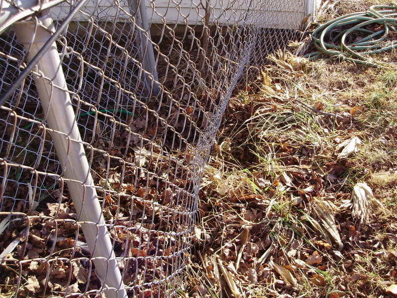

First time it's done that to me lol. After a quick look over it appears the fuel line interfered with the throttle control rod. I'm the one who routed the lines after the carb change so it's my fault. I could not believe I didn't break it on that fence. The lil f*cker must of been goin 50mph!
Point of impact :)
