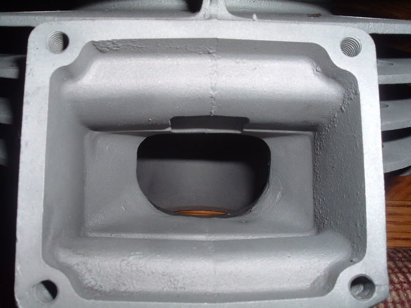

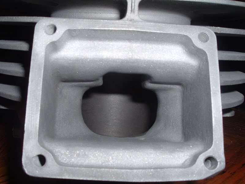

Here's side by side before and after pics of my motor for reference.

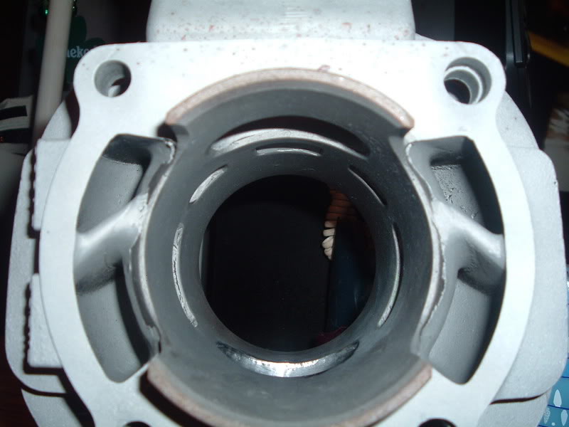

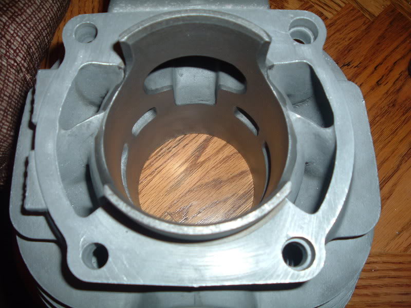

another comparison the pricey la sleeve sonic kit versus a stocker i ported
note the yamaha oem 12 port design actually has more port area than even the ct kit!
this kind of extensive work and adding auxilary triple exhaust ports is something that even most builders wont attmept ,so kids dont try this at home ...you *WILL*scrap your jug
