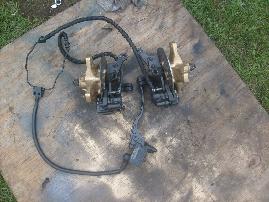

Check this out bud,bolt on ready to go,brand spankin new wheel bearings and pads are 80%.Moose racing lever,doesnt need rebuilding.200 bux shipped,goin on ebay noon sunday.they gotta go i need funds for my rebuilt motor.I like the forgiveness of the drums i didn't like the locking up front brakes,scary when going downhill in 4th gear.No cracked brake lines and torn seals either.
