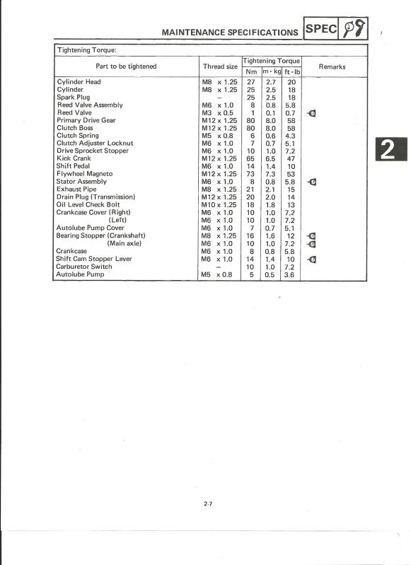

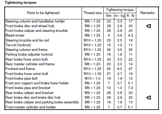

I must have posted these a hundred times so I figured I'm gonna make a few spec posts for those newbs who can't download a manual.
